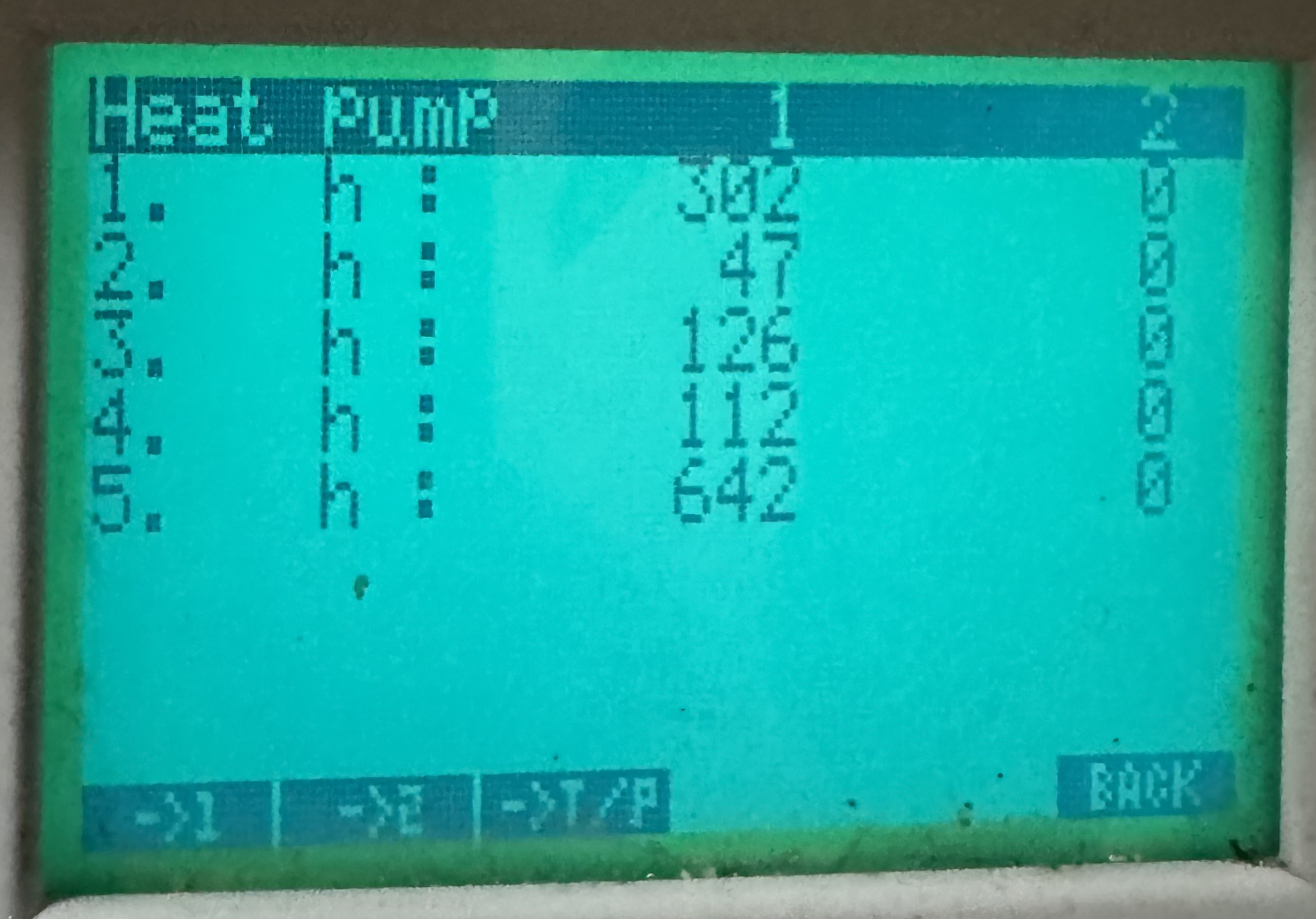

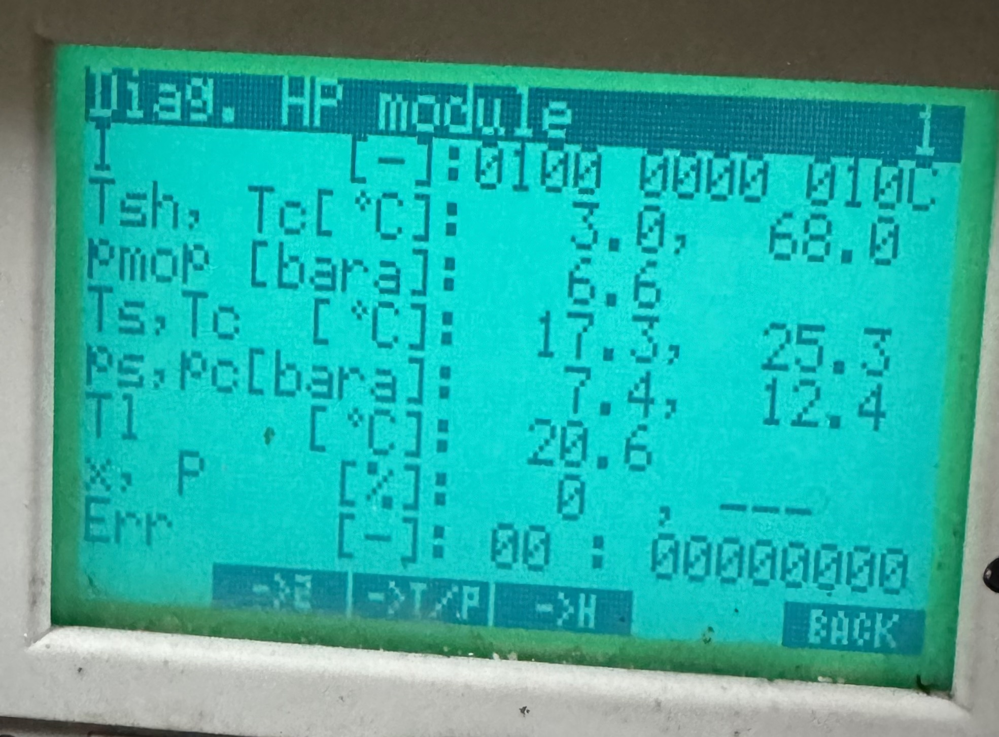

This winter, it doesn't seem the heating work anymore. The system does not show any error or message. The heating pump starts for 10-15 minutes and then stops for 5-6 hours. The temperature in the sensors seem correct (+/- 1 degree C) compared to external thermometer test.
I am attaching the display of the installation and the diagnostic screens. If anyone can help with any suggestions of how to debug this situation or what settings to change, I would be greatly appreciative.

is the compressor shown as running in the system overview (second column from the left, at the bottom)? If so, and the compressor is not running, the problem lies with the compressor control. Either the control signal is not coming from the base circuit board, the EEV circuit board is not transmitting the control signal, or the compressor contactor is defective. In most cases, this indicates a defect in the EEV controller.

Wenn der Verdichter läuft und es liegen nur 7,4bara/12,4bara im Kältekreis  an, dann würde ich auf Gasmangel tippen.
Vorausgesetzt ich interpretiere die obigen Werte im Display richtig.

If the compressor symbol moves but the compressor itself is not running, the control signal to the compressor contactor must be checked. This is done from the base board via the EEV controller to the compressor contactor.
