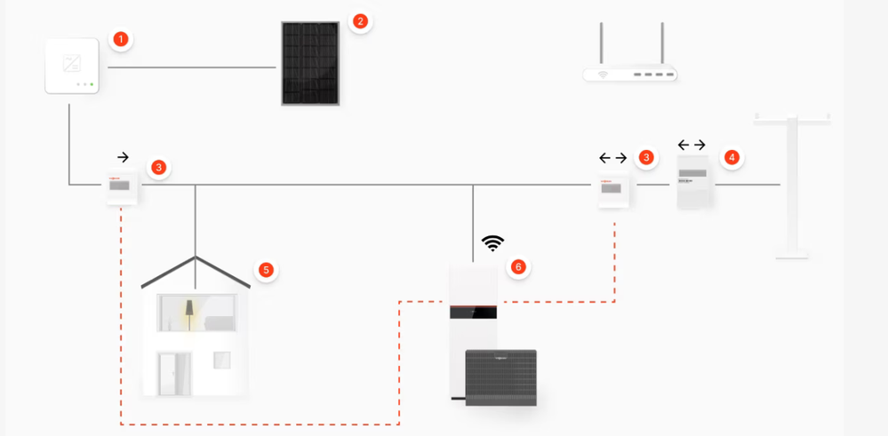

Where should I install the E380 CW. As far as I know, there should be 2 of them based on this schematic:

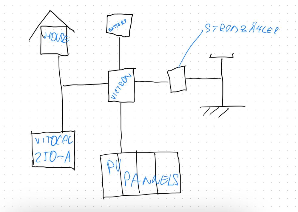

However, the Victron has a bit different wiring:

To use the internal energy management and the PV function of the Vitocal 250-A, an energy meter is required at the mains connection point and one in the PV supply line.

The problem is the second energy meter. In the schematic from Viessmann, the schema is:
However, the customer has the schema different:
So in this kind of set up:
You can see the difference in the pictures I posted before.

Everything is connected to AC Out as critical load. So if there is a power failure from the Grid, everything can run on batteries including the heat pump.
Personally I have a Vitocal 200 with WO1C in my house, I also have Victron and everything on AC Out (including the Vitocal), however, the WO1C need only 1 smart meter. The new One Base regulation needs 2 of them, which is quite tricky.
the PV Pannels are connect on DC with MPPT Solar charger directly to the battery , or with AC Inverter on AC IN?
IF AC Inverter, you can put the Smarmeter there.
could you please give us some more details about the Scenario "Drittanbieter Wechselrichter"
and the diagramm Jakub postet.
In case of the Victron we are not able the get the solar Power with the left Smartmeter, if he use DC Charger.
(it would be possibel by Modbus from the MP2 directly, but without a custom midleware we can not connect to the 250A, I know some people using openE3 to connect MP2 and 250-A directly)
Does the 250-A PV Energery management also work with one Smartmeter ?
Or what influence has the value of the Solar power Smartmeter?
What will happen if it's missing?
What will happen if Jakub install both Smartmeter on the right hand side at the Grid-point?
The Energery management should start to speed up the Heatpump if there is a feed in (> xWatt) at the Grid-point. Normaly this could be done without the second Smartmeter.
What is it doing?
Thank you
BR Michael
@qwert089 the MPPT is connected directly to batteries, so there is no place to install the second smart meter.

If a third-party inverter is used, the Solar-Log Gateway can be used. However, Victron is not listed there as a third-party manufacturer, which is why a connection is not possible.
