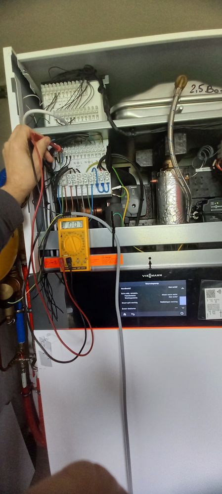

I have talked with my installer and send him some photo's
Also did i test the same situation but with two cables, one for the 230v 143.1 and another for the signal from the inverter. I put one cable on the ground (230v 143.1) and the other is shielded with the contact signal(143.4 and 143.5).
The problem is better but still resist, because when status 3 is active, the wire for status 4 get also the induction voltage in the same cable.
I measure two times 7 volt on 143.4 with two different status (3 and 4) from the heatpump. (see photo's)
I also want to add that when i release the wire from contact 143.4 or 143.5 on the heatpump, then the status return back to normal immediately (status 2)
