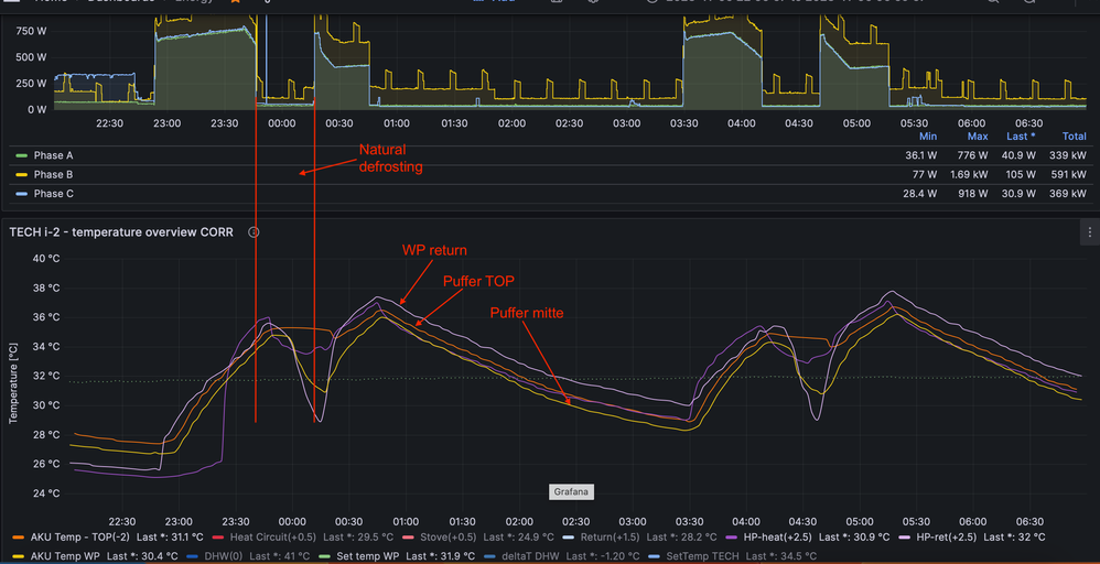

Dear community
dear Flo_Schneider
I am trying last time power of the community regarding this, very annoying issue with secondary pump.
It happens more and more often - it has probably something to do with actual external temperatures.
Again I have here a diagram showing that the secondary pump remains running after heating cycle, which causes massive mixing inside the Pufferspeicher - it is visible that after heating cycle at 00:45 WP-return temperature remains still on the same decreasing level as Pufferspeicher temperatures. Normally, this temperature of WP-return should go rapidly down if secondary pump stops. Also, again, it is obvious, that there was a Natural defrosting process, which interrupts heating, so it seems to me that it must be some bug in the firmware that causing this unexpected behaviour.
For you to have all the informations about my system, here also a simple scheme of the Pufferspeicher connection and temp sensors location.
It would really helps me if anybody can share some solution or advice
Best regards
Peter
