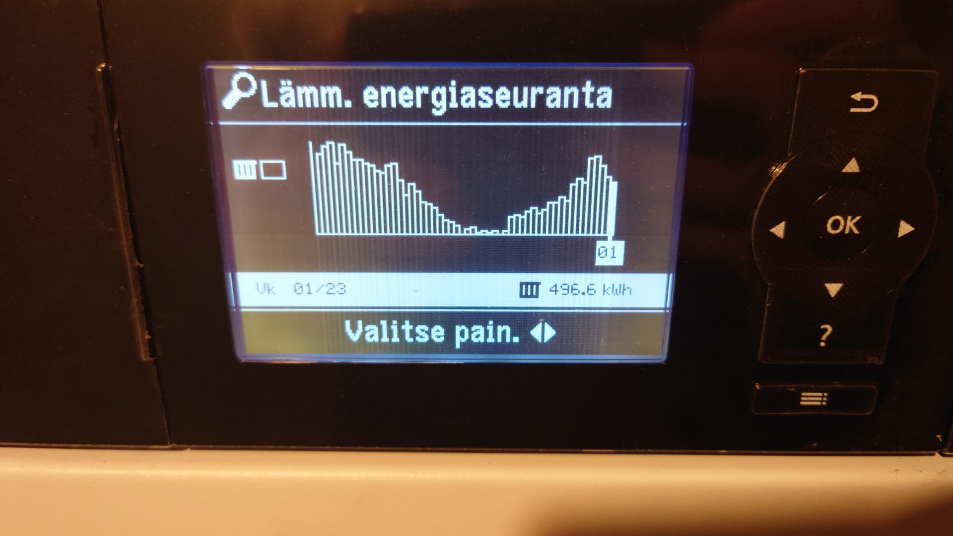

Is it possible with this heating device to see the amount of electricity consumed in kWh in addition to the heat energy produced? Now I can only see the amount of energy produced.
Is there some setting I need to change?
Thank You in advance for your answers
Hello vipu,
please check the following parameters:
8811: 2
8812: >1
8814: 1023
8815: 1023
8817: 1023
8818: 31
8819: 31
881A: 31
881B: 31
Some may be in the second coding level. To do this, press and hold the "OK" and "Reset" buttons for approx. 4 seconds in the service level (OK and menu). Then enter the code 344 254 1331. Important! Incorrect settings in the expert level can cause damage to the unit.
