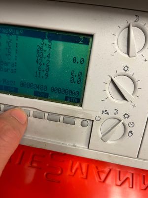

Hi Marcel, can you please help me out, i have error message 00000400 on my 300G (i07 EEV / A9)

Guten morgen,
Thank so much for your replay Divance.  Sorry to write in English, hope its ok. I can understand and read German answer.
Any clue what might be wrong whit my system? It sounds like the circulation pump runs, I suspect the EEV to be bad
The brine and secondary side has been filled upp.
Hello @Dextrocell
To check the operation of the expansion valve, it seems that it is not closing, which is why we are not achieving overheating on the suction side of the compressor.
