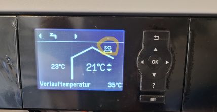

Hello Herr Schneider,
Meanwhile i have set-up the Smart grid connection and it is also active (see my screenshot) .
But the heatpump does NOT get triggered to start heating the higher temp in the WarmWater Storage.
I have done the 10 K increase in the Smart Grid menu.
Is there more I need to do ?
Take pictures of each side of the system overview when you think the heat pump should be heating. You can get there by holding down the ‘?’ button for approx. 4 seconds.
Best regards

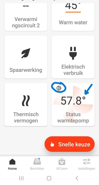

Hallo Herr Schneider,
I am coming back to you again to follow -up on my question above where I am wondering why my heatpump does not get triggered and does not heat up to the higher temperatures.
See the system overview pictures.
Can zou explain ?
Hello HdB_ST_57a,
can you tell me if the heat pump was running just before you took the pictures? The heat pump cannot reach a hot water temperature of 60°C without the help of an auxiliary heater (electric instantaneous water heater). If the 60°C was generated via the Smart Grid function, the instantaneous water heater can only switch on if it is forced operation (function 4). It will not switch on during on-demand operation (function 3). It must be enabled separately for function 4.
Best regards
