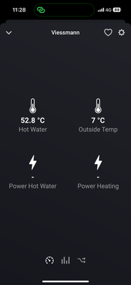

My intension is to make my code available at GitHub for anyone to use and contribute. All help to make the integration better is appreciated. I have a Homey app up and running but it is currently only reading outside temp and hot water temp from the API (see attached). Needs though some optimisation in how the data is requested. I'm currently on vacation but when I'm back home I can try to make it available on GitHub. I will let you know when I have made it available.
