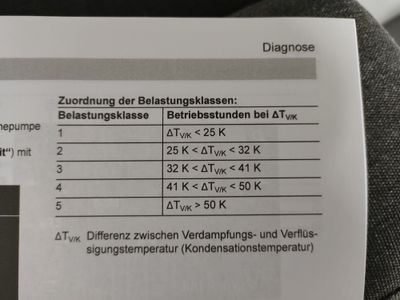

At the same time I do notice the API returns these data points: Compressor Hours Load Class 1 to Load Class 5. I am not sure how to read these values. Any pointers or documentation on this?

Same question for Vitocal-200 via Opto1.
You can propably  find the answer in "Serviceanleitung Vitotronic 200".
In Document 5832377 (which I did Not found online) these values are described on page 141. Within the API Documentation I did not find any hint regarding these values.
Kind regards Alex
Thanks for your response. Unfortunately these values do not help to get actual kWh consumption out of a Viessmann heat pump..
