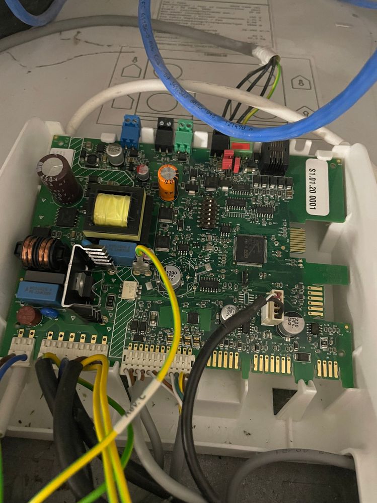

Hello @Flo_Schneider,
Sorry for the late reply, I waited for the company. So here are the pictures:
I see that there is a dip-switch on the middle of the motherboard. What should be the correct setting for the C400 model?
Best regards,
Tamas
Hello Tamas,
the dip switches remain as delivered and are not changed.
