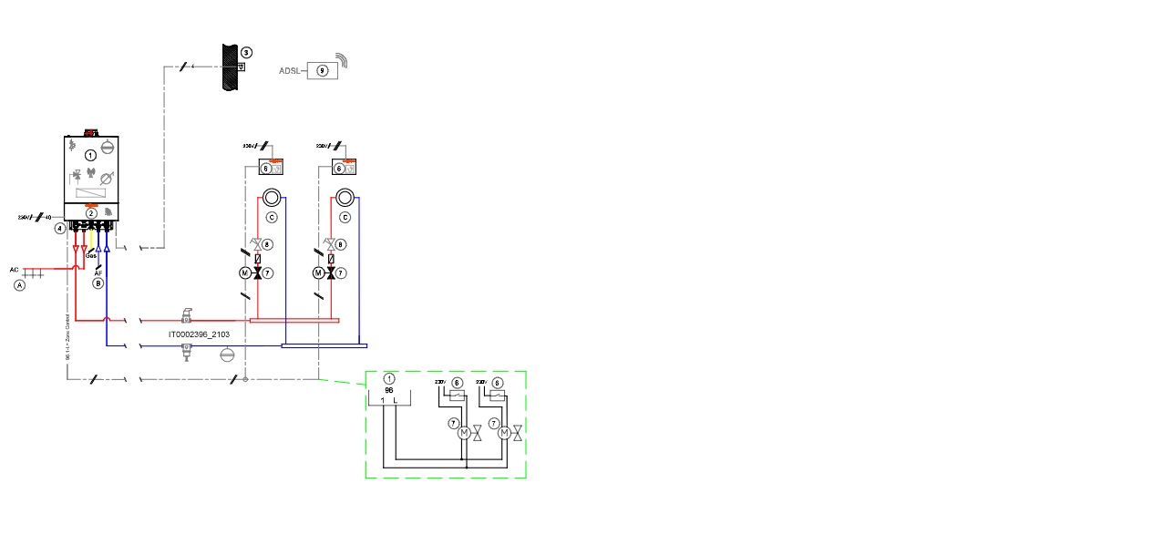

My current system is a 'zone system', with an on-off thermostat and a 4-wire on-off zone valve for each room (as shown in attached image).
Basically, when a thermostat requests it, the zone  valve is open and the boiler is turned on.
When all rooms have reached the requested temperature, the boiler is turned off.
