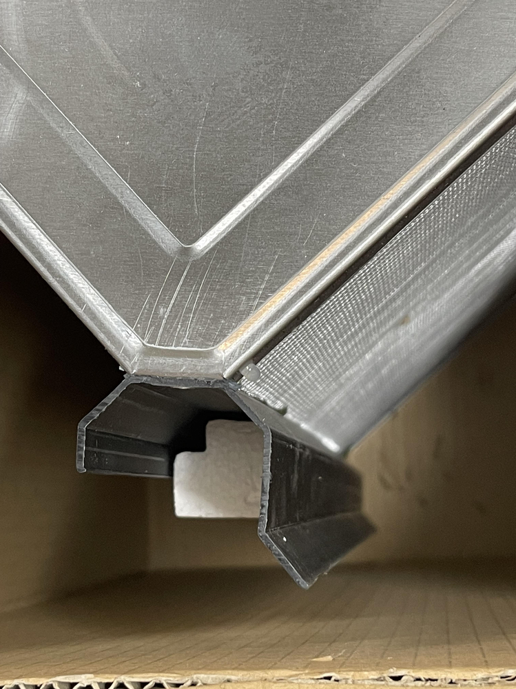

Someone on this forum has already posted a picture of a fixed version of heat exchanger with drip lip. Not sure why Viessmann does not offer it...Maybe someone can post a part number?
