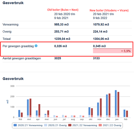

1. No room compensation or other kind of dynamic heating control
From a technical point of view everything should be in place to make for a more efficient boiler control algorithm that incorporates the differences between the current and set temperatures from all rooms. However this is not being used at all. It is still the same old "dumb, black box" weather compensation that is has been used for decades. The boiler follows the set heating curve according to the outside temperature and that's it. In practice this means slow heating in the morning when the rooms are cold, unnecessary overshoots when there is a lot of sun, unnecessary boiler short cycling when you reduce the temperature and just general bad efficiency.
Note that this makes my system less efficient then my previous owned 15-years old boiler controlled by an OpenTherm Nest thermostat. Due to the whole work-from-home covid situation my heating pattern and temperatures are identical for 2020 and 2021. These are the results taking into account degree-day correction:
Together with the installation of my Vitodens boiler in February 2021, my heating system has been completely hydronic balanced with Oventrop GHQ valves. Making the comparison even worse.
