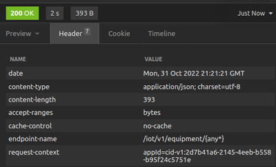

Excuse me for answering in English.
I also have the same problems since a while now.
The token is requested fine, but when using the Bearer token within a subsequent request, even with Postman or Insomnia, the first couple of times i get an error 500; afterwards, after a few minutes it works.
After a few minutes:
 I think this might be a bug...
