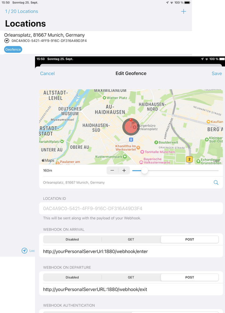

Locations Screen: First you have to set up your fence and a perimeter around it. Don’t make it too small, 150 – 2500 m should do the trick. The bigger the circumference, the more time you are giving the heating system to warm up your home.
Then configure your webhooks for enter and exit. Webhook is just another word for a web address which Locative is accessing to trigger an event. We’ll cover that later. See screenshot below. I strongly recommend using the POST method.
