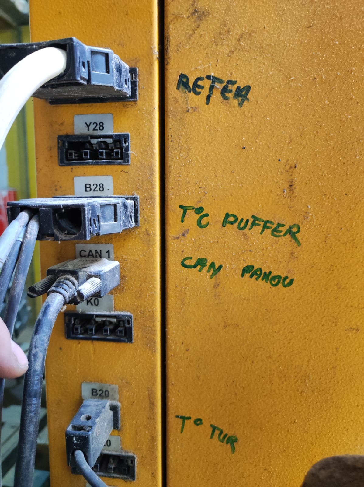

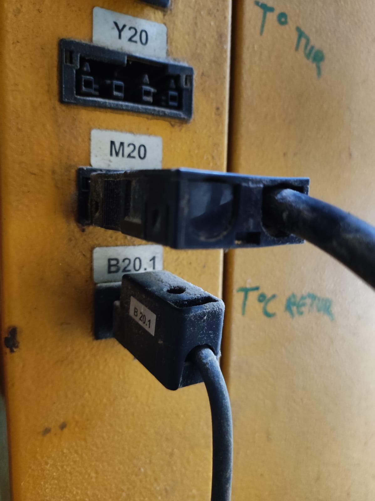

I have in Pyromat DYN 85, year of manufacture 2008, with Ecotronic control panel, and it shows "weather sensor interrupted". Where can I find this sensor so that I can change it, or it is possible that it doesn't have it at all. I bought it like that.
sockets behind the boiler
the labels:
400V - POWER SUPPLY
Y28 - mixer
B28 - sensors for temperatures at storage tank
CAN1 - to ecotronic Panel
K0 - ??? probabily power for a motor
B20 - sensor for temperature flow
Y20 -
M20 - kessel pumpen
B20.1 - sensor for temperature return flow
M1 - exhaust fan
B1 - sensor for temperature exhaust gas
B02 - sensor for safety temperature at snecke
CAN2 - to snecke motors
M16 -  igniter
U31 - power suply to snecke motors
