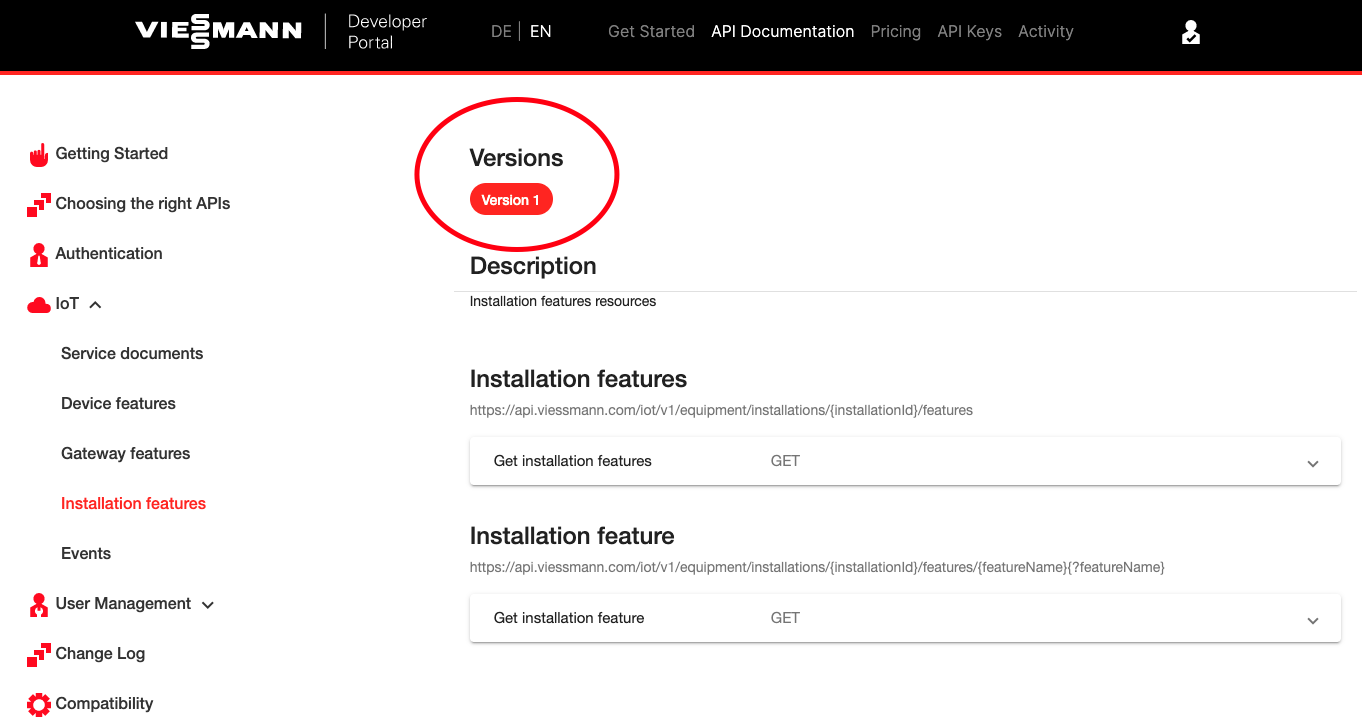

The versioning you are seeing is related to the services behind the API call and can be different for each service. You find the version of a service at the top of each page in the documentation, see the attachment image for installation features.
