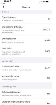

@CustomerCareMichael just for completeness here is also two screenshots.
1: before doing the manual one-off charging (as oneTimeCharge API call does not work)
2: after it started (with 34% modulation and one increase on burnerstart 14446 to 14447 as it is in danish)
The API still shows nothing about stats, so the information is passed to your central server but not available in the API.
