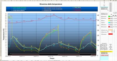

I managed to read and download some of the diagnostic values of the system through python scripts via the API and then dump the values in a csv file. With an Excel workbook I import the values from the csv and show them on a grafic to monitor (and learn) how the various temperatures moves and the pumps and compressor switch on and off when the system in on.
For example, here you can see the monitoring of today time from 12:16 to 18:14.
(due to the limitations of the API calls I can only monitor about 6 hours as I'm asking for 10 different values every 2 minutes)
