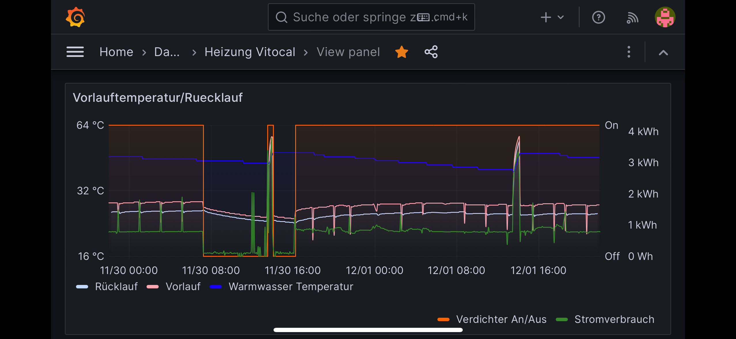

… ebenfalls eine Vitocal 200-A (Innenaufsellung) bei defrost Vorgängen stoppt der Verdichter nicht. Anbei eine Grafik, der orange Bereich stellt die Verdichter Starts dar.

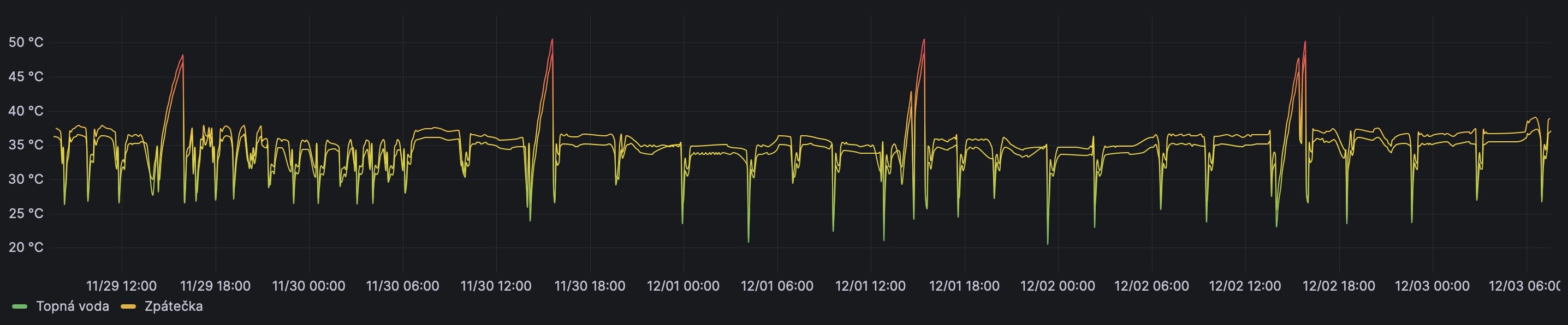

I had an identical problem with my Vitocal 222-S E.06 - i.e. the de-icing took place every hour and the heat pump returned to a normal heating operation after the de-cing process only in around 25-30 minutes. As a result, there was no time for our house to get properly heated. This happened at temperatures around 0°C. At the subzero temperatures the de-icing interval was a bit longer (1,5 to 2 hours) due to lower humidity. But still too frequent.
What seems to help in my case was to switch off the noise reduction mode for the outdoor unit (I was running the heat pump in the super silent mode all the time). You can clearly see this in the below picture. The end of November (the left part of the picture) there the de-icing took palce every hour. Then on November 30th, 2023 in the morning, I switched off the noise reduction mode and since then, the de-icing is less frequent (now the average time is 3 to 4 hours). Still not perfect but much better. As a result I get around 16 compressor starts per day instead of more than 30 starts.
The picture shows the heating water and return water temperatures and you can identify the de-icing process by the sharp decrease of the temperature in the graph. Also please note that after I switched off the noise reduction mode, the heating water temperatures always go a few degrees °C lower than when running in the super silent mode. I am still trying to interpret this but it seems to me that now (in the full operating mode) the de-icing is more effective and the system is able to take more heat from the system. Therefore the de-icing process is more thorough. It would be great if any one could comment on this.

... I forgot to mention in my previous post that it still takes more than 20 minutes for the system to get back to normal heating operation after the de-icing process (see the graph below - again, you can identify the de-icing process by the sharp decrease of the temperature in the graph). When de-icing is taking place the flow rate is pumped up to almost to 2500 l/h and after that it is modulated back to my standard 1600 l/h. It is this modulation of the valve that takes those 20-30 minutes and the proper heating only takes place when the flow rates is around 1600l/h.
