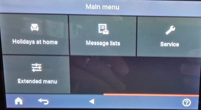

Unfortunately, my device doesn't have such a menu. I'm attaching pictures of what happens after I enter service menu.
Enter Service menu
And now I get only this:
I'm not sure what will happen if i enter "Commissioning" menu.
You are right, even though it is written in the service manual of Vitocal 200-S it seems the service menu is not available till now.
