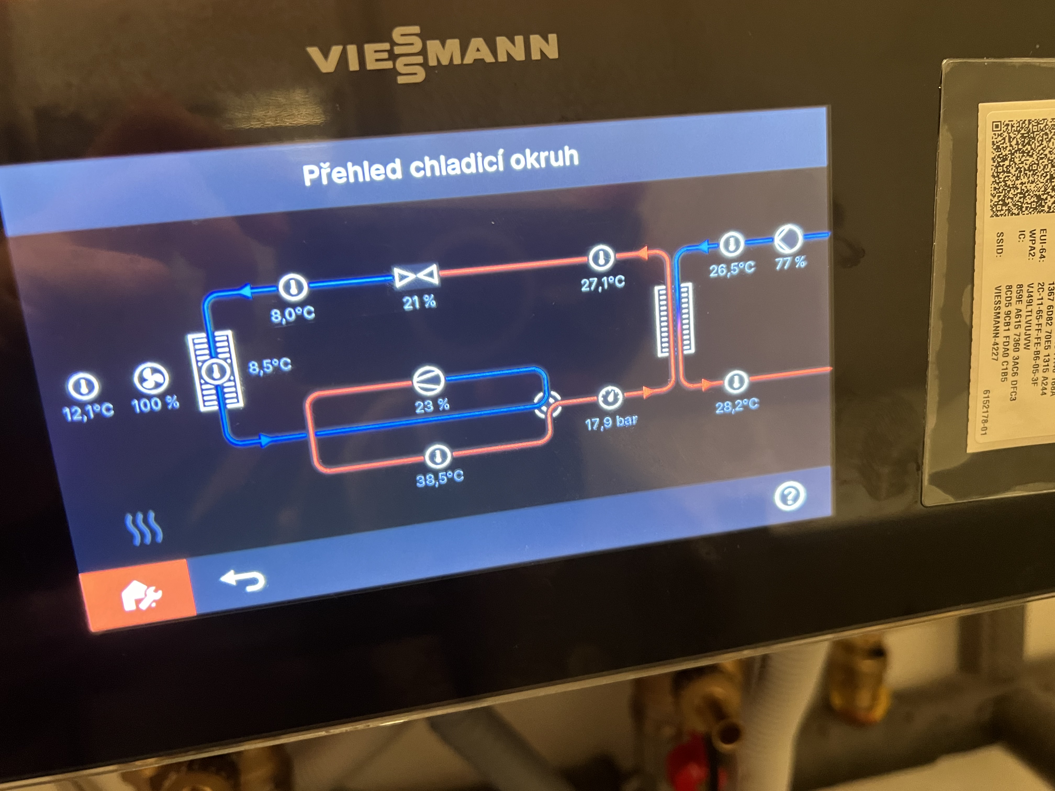

Dear Guennie,
I red that you have a Viessmann 250 and is a very quiet ( no noise in 1-2 meters)
I have a new Vitocall 200 S E ( R32) and ventilator is going on full speed 100% if heating in any time ( i have only floor heating). Expl. temperature inside 22, outside aproxx. 13, floor heating 27 cels., kompressor 22%, power 3,5 kw but ventilator 100% and noisy.
Is it correct? According what parameters ventilator moduliriet?
thank you!
pavel

Dear Guennie,
I am sorry to bother you, but it can be visible from foto that system is running right…( for example input and output ?)Kurve 0,3, onnly floor heating…., water cilculator running aproxx 75%, flow aproxx. 1450 l, ventilator mostly on 100% sometimes on 90%.
thank you very much!
PaveK
Hello,
I have a heat pump from the previous series, where you still had access to the parameters.
Judging by the photo, however, this is a heat pump of the completely new generation, with the new software concept.
Unfortunately, with this new software concept, you can hardly adjust anything yourself. You must therefore report this problem directly to your installer. He will then forward this issue to Viessmann's technical service.
As far as I know, there are still some teething problems in the software of the new heat pump series, so it may well be that you need a software update to solve this problem.
Regards,
Guennie
