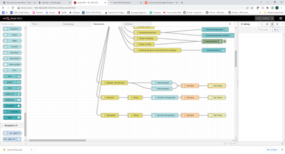

Update:The flow can be simplified a bit by connecting the silder's payload directly to the function node. That way no context variable for the temperature setting is needed. The function node then looks like this:
var atoken = flow.get('accessToken')
var setTo = msg.payload
msg.payload = {"targetTemperature": setTo}
msg.headers = {};
msg.headers['content-type'] = 'application/json',
msg.headers['Authorization'] = "Bearer " + atoken;
msg.installationID = flow.get('installationID');
msg.gatewaySerial = flow.get('gatewaySerial');
msg.deviceId = flow.get('deviceID');
return msg;
and the simplified flow looks like this:
