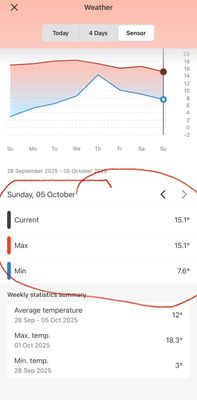

There is a long-term bug in the ViCare app display of temperature sensor data. The graph always shows one day in the past on the x-axis.
For example, today is Monday, however the graph always shows Sunday - please see the attached images.
The boiler date and time is correct and it is clear from the images that the app is aware that it is October 6th, so it looks like the code might be using the wrong day of week reference internally.

What is odd is that the system knows it is October 6th - the boiler reports that date and it is included in the heading of the app page. I can imagine the reports being out of alignment by an hour or two, but the chart and the 'live' min/max/current  are all dated yesterday.
So to your suggestion - I just fixed my TZ to Berlin and the graph and report are now correct (without restarting the app).
Changing to Lisbon or Dublin, same TZ as UK, reintroduces the issue. New York is the same .. so maybe 12:00 and 00:00 are swapped around somewhere..
Perhaps you can check your data in the morning local time to see if something is different for you?
Sydney (currently 00:50 on 7th) shows Tuesday on the graph (no data) but Monday on the day readings.
